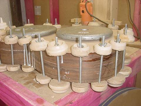

Let's start over on this baby, we want all the details Stan.
Top Wood?
Back and side wood?
Bracing?
Rosette?
Top Dome Arching?
Rear Dome Arching?
Top thickness?
Back thickness?
What is the body shape?
What is the scale length?
What else can you tell us about this guitfiddle?

top started with ls redwood, but i messed something up and it will be a bearclaw sitka. Back and rim are coco from Bob C. The binding will be from Bob and is going to be zooty maple, with either herringbone or bwb purfeling. I haven't decided that yet. Back is 20ft, top 28ft. Scale will be 24.9 on a 000/OM body. Will be 5 piece lam maple/rw/maple (thanks John Mayes for the class)/Braces are I think sitka (Thanks Bruce D)Will be ebony fingerboard and ebony pyramid bridge, bone nut and saddle, ebony head veneer, gotoh tuners, martin strings. Hope this answers all. Most of all I just want to do it right for Aaron and have his dad in our prayers as he serves out country and to help others
Stan
